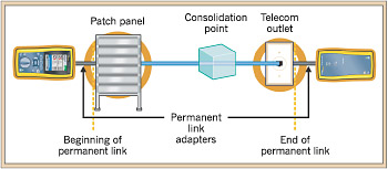

Link models. The term “link model” refers to configuration of the cabling link under test and the manner in which the test equipment is connected to the link. Most certification tests in the field should use the permanent link model, which consists of the cable and the permanent connectors in the wall outlet or patch panel.
The connection from the test instrument to the permanent link is via a permanent link adapter (Fig. 1). In a practical sense, this means field testers must be much more sophisticated because they must be able to measure the performance of the link without any of the effects of the test cords with which they’re connected to the link.
The reference point for the measurements isn’t at the test instrument but at the far end of the test cord. From an installer’s perspective, this means that if the effect of the adapter isn’t completely transparent, a good link can produce a failing test result. The likelihood of a false failure increases with performance requirements. In other words, Cat. 6 cables are more likely to produce false failures. Therefore, when performing permanent link tests, make sure you’re using adapters appropriate for the cabling under test (especially for Cat. 6/Class E links).
