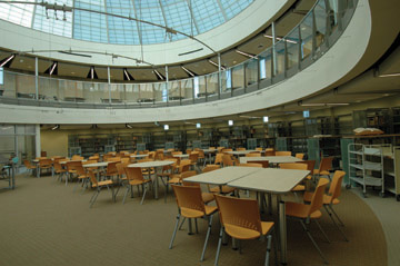

“In addition, we employed sun-shading devices on the building's large windows to reduce solar gain in the warmer months,” says Joseph Fuller, principal of Fuller and D'Angelo, the Elmsford, N.Y.-headquartered architect firm that designed AITE. “To ensure there is ample natural illumination, the school features a 60-ft translucent dome above the 3-story library media center and teacher work room.”
