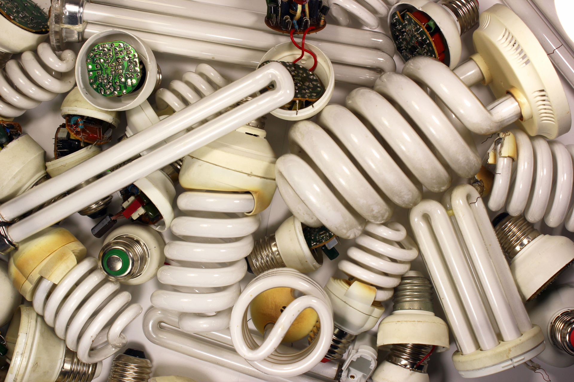

The traditional fluorescent lamp used in factories and offices — for example, the T8 or similar — is the one you are most likely to have waste disposal issues with because this lamp is so common. Fluorescent lamps contain mercury, so simply tossing old ones in the dumpster is not an option. Other types of lamps also contain mercury, including HID, metal halide, and high-pressure sodium. And other toxic materials may be present.
These lamps pose zero risk when installed properly and left alone. The risk comes in when a lamp is removed or while a new one is installed. Either way, take extra care not to break the lamp. When installing, ensure the new lamp is securely mounted. If it is a two-pin twist-in, for example, twist it all the way to its stop position. Never tape old lamps together; that greatly increases the risk that one or more lamps will implode.
Lamps that have been removed due to not functioning properly anymore need to be stored in a way that protects them from breakage. If you’re replacing a lamp, put the old one in the box the new one came in. Do that right where you did the replacement so you have a protected lamp to carry to wherever you are storing the old lamps.
