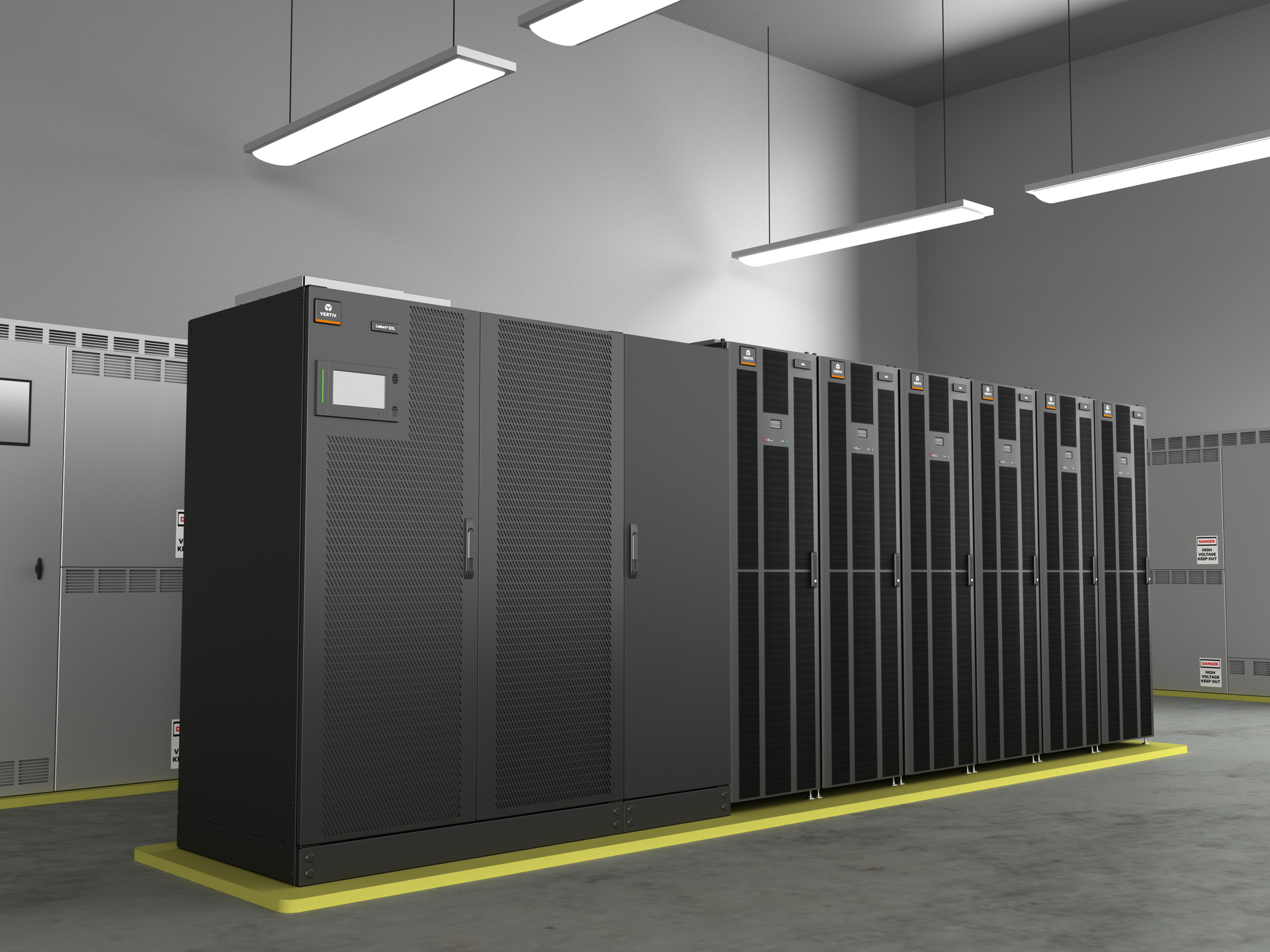

In 2018, the National Fire Protection Association (NFPA) released code revisions that provide direction on the use of lithium-ion batteries in UPS applications. The code covers a range of areas such as the battery enclosure, the battery management system, and battery location. This was an important first step in clarifying the issues around lithium-ion deployment in data centers, but the NFPA code has also created some uncertainty among potential users.
That’s because the NFPA is also developing a supplemental standard to support the top-line code and this supplemental standard has yet to be released. Plus, state regulators determine when to adopt the revised national code and it typically takes years for states to complete that process. To date, only California has adopted the national code, and it is hoped that the pending supplemental standard will be issued before other states adopt the recent national code revisions
Of particular concern to potential users is the new national code’s requirement that lithium-ion battery cabinets that have not yet passed new testing related to the potential for thermal runaway must be spaced at least three feet apart to eliminate risk. This spacing requirement makes the application of lithium-ion batteries impractical in most data centers, and some operators are unsure how local officials will interpret the code.
However, while code development and adoption are moving more slowly than some would like, advances in testing can compensate for the current gaps. For large lithium-ion batteries used with UPS systems, UL has developed standard testing and qualification processes that ensure safety. The individual battery cells are addressed under UL 1642, Standard for Lithium Batteries, which includes abuse tolerance tests. UL 1973, Standard for Batteries for Use in Stationary, Vehicle Auxiliary Power and Light Electric Rail (LER) Applications, covers the battery system as a whole and outlines a series of safety tests on issues such as overcharging, short-circuit exposure and high temperature. This has resulted in the ready availability of UL-tested lithium-ion battery systems for data centers.
