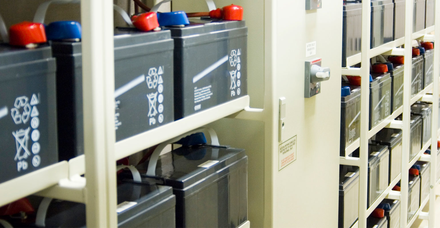

Article 320 of NFPA 70E provides safety requirements for working on and around storage batteries. As with other Articles in this standard, it takes a concept approach rather than a highly detailed, prescriptive approach. This fact becomes clear at the outset, when you read the Informational Note under the Scope [320.1]. It lists not just two or three other standards, but eleven.
These other standards provide “additional information on best practices for working with exposed stationary batteries that exceed 50V, nominal.” Six of these are IEEE standards, two are NFPA standards, and two are OSHA standards. There’s one from DHHS (NIOSH).

The room
Each battery room or enclosure must be accessible to only authorized personnel [320.3(A)(2)(c)]. Does this mean a sign or a lock? Art. 320 doesn’t say, so consider these things.
Locks almost certainly ensure there won’t be unauthorized access. However, locks cost money and can cause delays when quick access is critical. If conditions are such at the facility that a sign will do the job, a sign may be sufficient.
For example, in a limited access facility, such as a manufacturing plant or power generating plant, a physical lock can also be used, but a sign may be all that’s needed if all employees are properly trained.
At one Midwestern power generating plant, two emergency generator rooms have double doors. Years ago (and maybe still), those doors were normally left standing open. Nobody entered either room without going to the operations room, verbally obtaining permission, and signing a form with expected entry time and exit time. This was an administrative control, and nobody ever violated it. Under certain conditions (e.g., smoke detected), an alarm would sound, and the doors would close in 60 seconds.
This plant had many rooms with “administratively locked” doors. You’d swipe your card before entering and when leaving; the operators could monitor occupancy on their screen. This kind of “honor system” works if everyone is trained and the whole facility is securely restricted access. If not, keep untrained people from encountering dangerous equipment via locks and/or other barriers.

Tools and equipment
The handles of tools and equipment must be listed as insulated for the maximum working voltage [320.3(C)(2)(a)]. Another requirement is the battery terminals and all electrical conductors be kept clear of unintended contact with tools, test equipment, liquid containers, and other foreign objects [320.3(C)(2)(b)]. At first glance, it would seem this is worded backward; simply keep your tools away from the battery terminal conductors to prevent accidental contact. Good luck with that.
One of the protection techniques is to place an insulating barrier, such as an insulating blanket, over the terminals or conductors you want to protect from accidental contact. This way you’re not relying on a lack of human error to prevent a catastrophe.
NFPA 70E requires performing a risk assessment [110.1(G)]. That assessment might reveal the presence of flammable gases, which are often found in battery rooms. If that’s not the case or even might be the case, that assessment justifies the use of non-sparking tools. If it does, use of those tools is required [320.3(C)(2)(c)].
It’s OK to vent
The vented lead acid battery is the most common battery type used in high-density, high-reliability applications such as data centers. Gassing is a natural consequence of the chemical reaction inside the jar, and that’s why these batteries have vents. Ensure vents are unobstructed [320.3(D)].
Cell flame arresters are also commonly used, but their operation depends on their proper installation and maintenance. If you see cell flame arresters, stop. Ensure the maintenance procedure addresses them. If not, use the manufacturer’s instructions to update those procedures.
