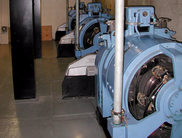

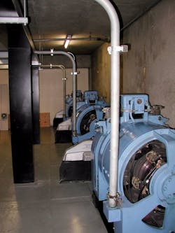

Many large DC motors remain in service, and they are frequently replaced with in-kind units.
DC motors may have wound rotors with permanent magnets or wound stators. The great advantage of a permanent magnet stator in a DC motor is that the motor is lighter and more compact. Recent developments in permanent magnet technology have resulted in this variation finding its way into more powerful motors (Photo). Maintenance is a key component to a motor’s operation and performance. Let’s take a look at what this entails for DC motors.
