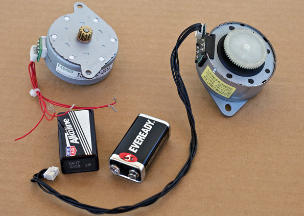

Stepper motors like these are used in inkjet printers and similar home and office machines. They can be powered and manually stepped for testing purposes using a 9V battery.

The NEC does not require very small motors to have nameplates. Step motors can be distinguished from small DC motors by the presence of many wires as opposed to a 2-wire design. There is not a consistent color code, but the common wire can be identified by “ringing out” the motor with an ohmmeter. You can also manually pulse a step motor using a 9V battery.
