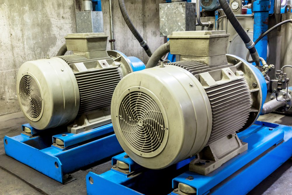

Using a rotation tester when installing a motor saves time and prevents problems such as driving the load backward. In some cases, you must get the motor rotation correct or massive damage will occur. Some equipment isn’t designed to run in reverse. And for some equipment that can be run in reverse, you really don’t want to do that (a sewage pump, for example).
So you connect the motor and, using the rotation tester, discover it runs backward. How do you fix this? Well, that depends on the kind of motor you’re working with.
