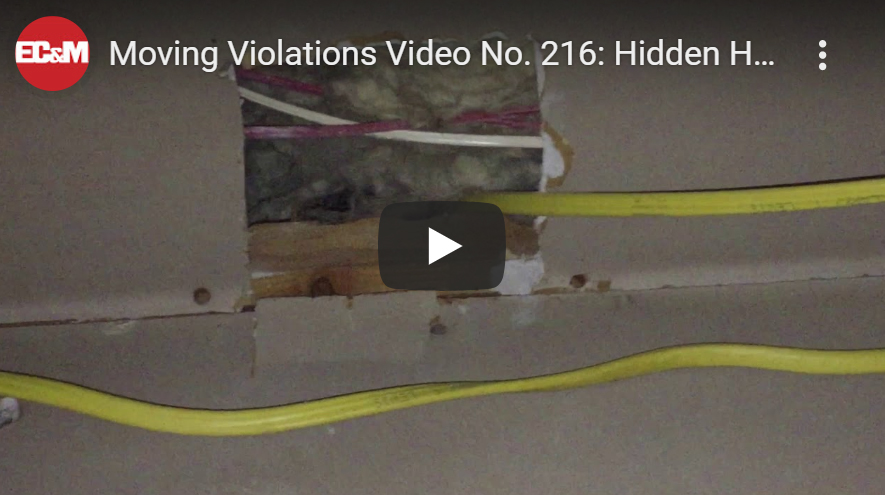

Moving Violations Video No. 216: Hidden Hazards Above Your Head
It’s always interesting when Russ pokes his head up into a suspended ceiling. In this episode, he finds a number of NEC violations. NM cables were strung about unsupported. Boxes had no covers. There were even large holes in the walls with no firestop materials present.
