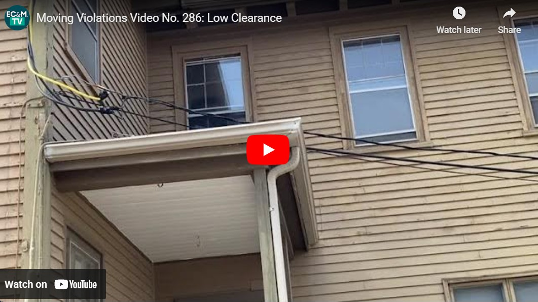

Russ shows us a new service with several violations of the NEC.
May 4, 2023
In this episode of Moving Violations, Russ shows us a house with a new service. However, there are a few violations with the new service, including low clearance over part of the roof. This a violation of Sec. 230.24, which requires clearance of 8 ft above a roof surface. Another issue is the close proximity of the service to the window, which violates Sec. 230.9(A).
