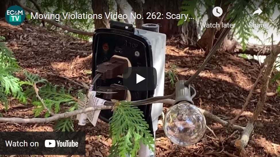

Russ spotted this exposed receptacle while eating lunch in an outdoor dining area.
Russ spotted this exposed receptacle while eating lunch in an outdoor dining area. The broken cover creates a violation of Sec. 110.12(B) in the 2020 NEC. There’s a good chance the cover broke because it wasn’t an extra-duty type unit, as required by Sec. 406.9(B)(1).
