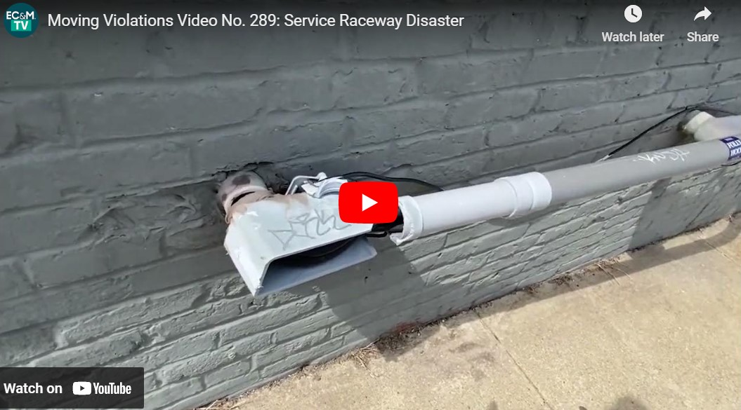

Russ looks at some service raceways that have serious violations.
In this episode, Russ looks at some service raceways that have serious violations. For starters, neither raceway is supported as it should be, which is a violation of Sec. 352.30. In addition, there is no expansion fitting, which violates Sec. 352. 44. These violations have left the conductors exposed and at risk of severe damage.
