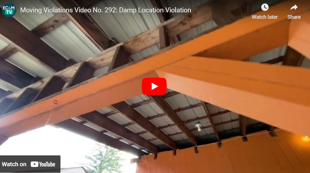

Russ shows us some NM cable installed in an outdoor overhang
In this edition of Moving Violations, Russ shows us some NM cable installed in an outdoor overhang. Although the location has some weather protection, it would still fall under the NEC definition of a “damp location.” Because of that, the installation violates Sec. 334.12(B)(4), which does not permit NM cable to be installed in wet or damp locations.
