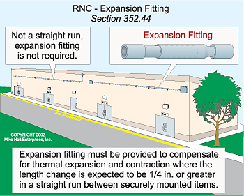

When is an expansion fitting required for rigid nonmetallic conduit?
A. An expansion fitting is required to compensate for thermal expansion and contraction where the length of the raceway change is expected to be .25 in. or greater in a straight run between securely mounted items, such as boxes, cabinets, elbows, or other conduit terminations (352.44) (Figure).
Listing instructions that are provided with expansion fittings indicate that you should add 30°F to the ambient temperature when you're installing the raceway in direct sunlight. Assuming a high ambient temperature of 90°F (plus 30°F due to solar heating) and a low temperature of 0°F (no solar exposure), the temperature change will be 120°F. Table 352.44(A) indicates that the total expansion and contraction length change for 120°F would be 4.9 in. for a 100-ft run.
Be careful, because if the ambient temperature during installation is high, you should realize that the conduit is at its expanded range and will contract when the temperature drops. Of course, the opposite applies if the ambient temperature is low.
Where direct-buried raceways are subject to movement by settlement or frost, raceways shall contain expansion fittings to prevent damage to the enclosed conductors [300.5(J)].
