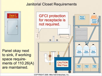

How far away must a 120/208V, 3-phase panelboard be located from a janitorial closet sink?
Q. How far away must a 120/208V, 3-phase panelboard be located from a janitorial closet sink?
A. You may install the panelboard as close as you like to a janitorial sink; however, a minimum of 36 in. deep by 30 in. wide of clear working space is required in front of the panelboard [110.26(A)].
