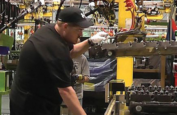

Photo 2. At this Columbus, Ind. engine plant, an operator is unloading assembled cylinder heads from a delivery crane. All throughout the plant, cranes enable the safe and efficient flow of work in progress (Photos courtesy of Cummins).
