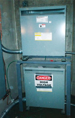

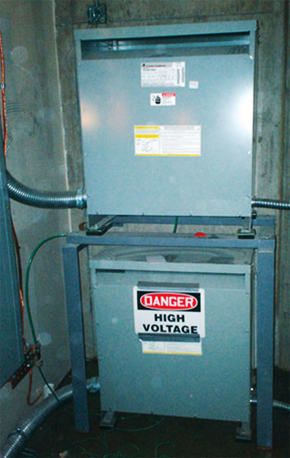

Inrush current should be taken into account when sizing small transformer primary side breakers or fuses.
Most petrochemical industrial facilities have numerous small (30kVA or 45kVA) transformers spread throughout the process units serving lighting and power distribution panelboards. In the U.S., the typical scenario is the transformers are fed on the primary side with a 480VAC, 3-phase circuit and stepped down to feed 208Y/120VAC, 3-phase at a panelboard. The 480V primary overcurrent protective device (OCPD) is either a thermal magnetic breaker or a set of fuses. It’s also common to see a main breaker for a secondary OCPD (main circuit breaker) installed in the panelboard for transformer secondary protection.
