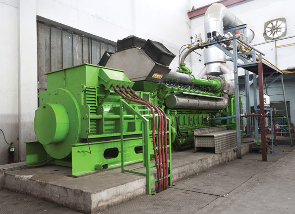

Can you tell if this is legally required or optional? Answer: No (-100rehanphoto/collection/Thinkstock).
It’s costly to save money by adopting the “What can I get by with?” mentality. You actually save money by thinking through the correct answer to “How can we ensure the standby system will reliably support the load under the conditions we impose?”
For the feedback issue in particular, you want a complete answer to the question, “How can we make sure we always know what’s going on in this system?” Consider including a designated company spokesperson in “we,” so if there’s an incident that person (promptly notified) has additional time to prepare a statement.
