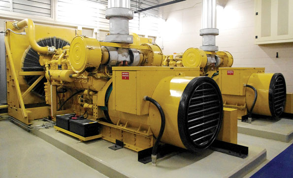

Photo 1. Notice the starting batteries on this standby power system gen-set (lower left of photo).
The standby power system has only starting batteries (Photo 1). It’s there to cope with peak load periods or power special equipment as operationally needed. The generators are the type that come up to speed slowly and run for a long time.
The standby power system in this example is only one of many possible variations. This particular configuration is different enough from an emergency system to illustrate that standby power isn’t emergency power. Many optional standby systems do have batteries and do transfer the load automatically upon loss of power. The generator(s) may be fast start and short run, slow start and long run, or a mix of the two.
