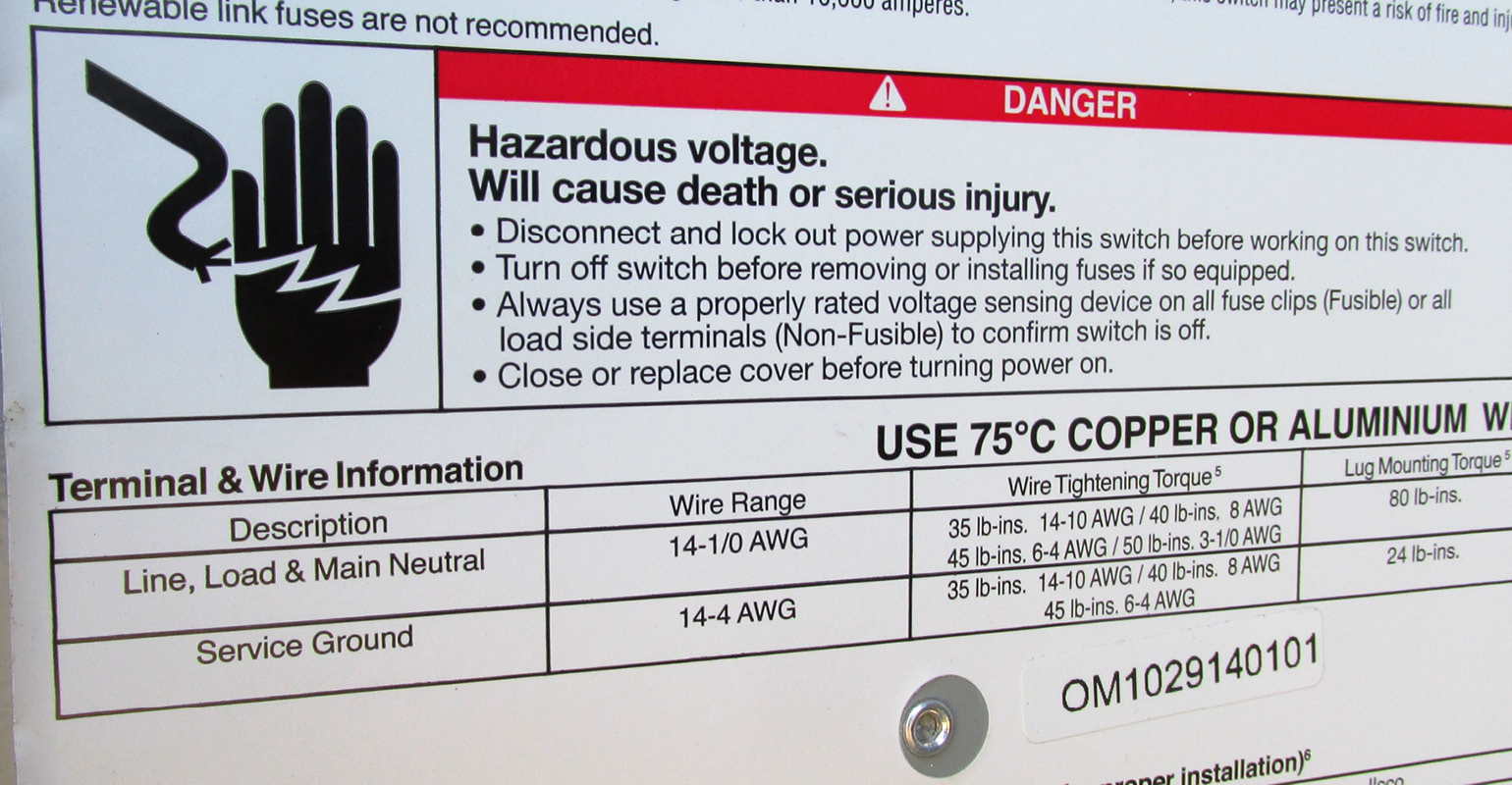

Thus, the requirement in Sec. 110.2 and the defined terms above hopefully helps us understand the value of markings and installation instructions. It’s important to realize that AHJs are approving hundreds and thousands of individual products. Those products will be installed on small, simple installations; large, complex installations; and every type of installation in between those extremes. Many of these products are available from numerous manufacturers. That being said, providing products with clear, complete, and concise markings (Photo 1 on page C16) and installation instructions is critical to the AHJ for approval, and ultimately for the benefit of customers. (Photo 2).
