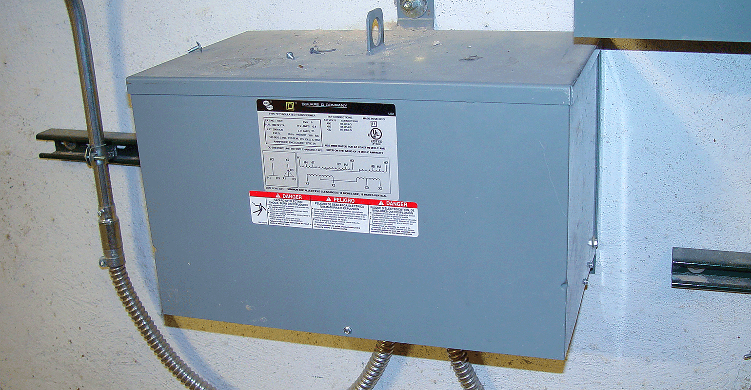

As an electrical Code enforcement official, my goal is to help you understand the impact of markings and installation instructions — especially when it comes to ratings, sizing, and product markings (Photo 1). Let’s look at some marking examples to test your knowledge.

Photo 1. Manufacturers’ product markings and nameplates play a huge role in the AHJ’s ability to evaluate electrical products on the job site.
