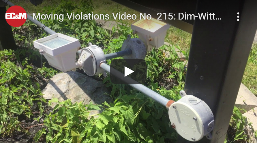

Moving Violations Video No. 215: Dim-Witted Install
Here’s another example of what not to do when adding lighting equipment to a sign. Although the NEC allows a box or enclosure to be supported by a raceway, the conduits must have threaded ends and be secured wrenchtight in the enclosure or hub. In addition, the conduit must be supported within 18 in. of the box or enclosure. Neither of these requirements are met at this location.
