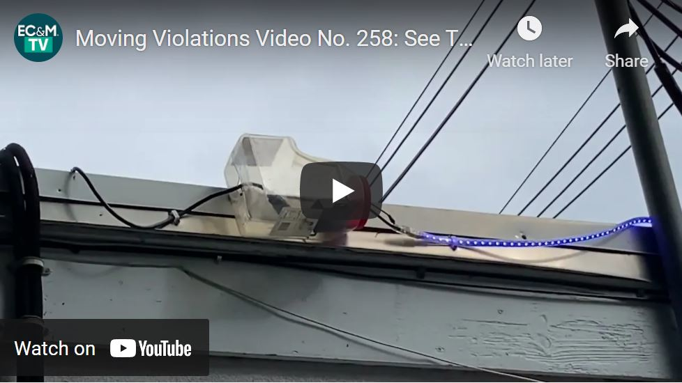

Russ noticed this crazy installation on the side of a restaurant building.
Russ noticed this crazy installation on the side of a restaurant building. Yes, that’s a plastic food container of some sort housing the connection between a power supply cord and a LED rope light. The plastic container violates the requirements of Sec. 110.8 of the 2020 NEC. In addition, the LED rope light is most likely not designed for use outdoors. That would be a violation of Sec. 110.3(B).
