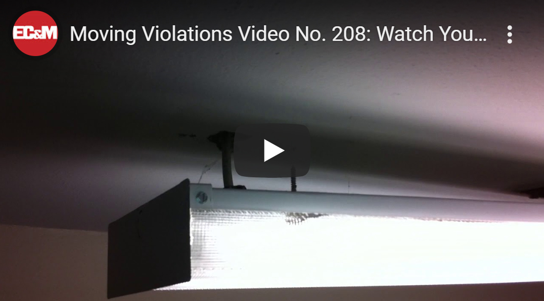

Russ found this sagging luminaire in a stairwell and decided to check it out a bit more closely. When he did, it was apparent that the installer did not meet the requirements of Sec. 410.30(A) of the 2020 NEC. Driving a screw into drywall might hold up initially, but it’s not going to hold for long.
