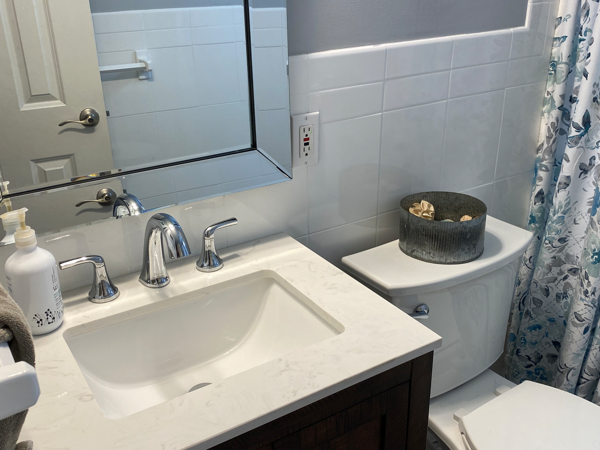

When first introduced in 1999, Sec. 210.11(C)(3) stated: “In addition to the number of branch circuits required by other parts of this Section, at least one 20A branch circuit shall be provided to supply bathroom receptacle outlet(s).” No voltage rating of the circuit was referenced, and it did not specify that the receptacle next to the sink was required to be on the 20A circuit. This main rule remained unchanged until 2014.
In 2014 it was revised to state: “In addition to the number of branch circuits required by other parts of this Section, at least one 120V, 20A branch circuit shall be provided to supply a bathroom receptacle outlet(s). Such circuits shall have no other outlets.” A voltage was finally specified after 15 years, but the literal wording still required only one bathroom receptacle on a 20A circuit even if the house had four bathrooms.
In 2017 it was revised yet again to state: “In addition to the number of branch circuits required by other parts of this Section, at least one 120V, 20A branch circuit shall be provided to supply the bathroom(s) receptacle outlet(s). Such circuits shall have no other outlets.” This revision required all bathroom receptacles to be on a 20A circuit. This rule finally included the receptacle near the sink; however, it also included receptacles for towel warmers, self-cleaning toilets, picture lights, sump pumps, etc.
For 2020, it was revised yet again and now states: “In addition to the number of branch circuits required by other parts of this section, one or more 120V, 20A branch circuit shall be provided to supply the bathroom(s) receptacle outlet(s) required by 210.52(D) and any countertop and similar work surface receptacle outlets. Such circuits shall have no other outlets.” Now this rule only applies to receptacles installed within 3 ft of the sink to comply with Sec. 210.52(D) and receptacles for dressing/changing areas and other countertops/work surfaces.
I feel the 2020 edition closely matches what the original intent of the rule was in the first place. What do you think?
