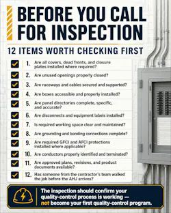

Internal quality control protects the contractor
Some contractors look at quality control as an added burden. I see it differently. Internal quality control protects the contractor by reducing failed inspections, rework, return trips, and embarrassing conversations with owners and general contractors. It helps train younger electricians and assists foremen with identifying patterns before they become company-wide habits. It also creates a more professional relationship with the AHJ because the contractor demonstrates that inspection readiness is being taken seriously.
A simple internal checklist can make a significant difference. It does not need to be complicated, and, in fact, if it is too complicated, nobody will use it. The best checklists are practical, job specific, and focused on the items most likely to cause inspection problems.
For example, a rough-in checklist may focus on box fill, cable and raceway support, protection from physical damage, bored holes, nail plates, equipment locations, bonding paths, and coordination with other trades. A final inspection checklist may focus on covers, labels, directories, working space, GFCI and AFCI protection, disconnect identification, unused openings, equipment access, grounding and bonding completion, and required documentation.
The point of a checklist is not to replace knowledge of the Code. It is to build a process that forces someone to slow down and verify the basics before the inspector is called.
That process also helps identify training needs. If the same correction appears on multiple jobs, that is not merely an inspection issue; it is a training issue. Contractors should track repeated corrections and use them to improve their internal education. Inspectors see patterns. Contractors should see them too.

The best inspection is usually the least dramatic one
A good inspection should not feel like a courtroom battle or guessing game. It should not require the inspector to uncover a long list of basic unfinished items before the real inspection can even begin.
The best inspections are usually the least dramatic ones. The inspector arrives, the correct area is ready, the foreman or responsible person understands the installation, the approved plans are available, the work is accessible, the equipment is labeled, and the obvious completion items are done. Questions are answered professionally, and, if a legitimate issue is identified, it is discussed clearly and corrected properly.
This is how the process should work. Electrical inspectors have an important job, but so do electricians, contractors, engineers, and facility personnel. The inspection process works best when each party understands its role. The contractor installs and verifies the work. The designer provides the design. The installer follows the Code, approved plans, product listings, and manufacturer instructions. The inspector verifies compliance for the AHJ. When the inspector becomes the first person performing meaningful quality control, that process has already broken down.
The solution is not complicated — but it does require discipline. Walk the job before the inspector does. Look for the obvious. Verify the documentation. Correct known issues before the inspection request. Train crews based on repeated corrections. Treat inspection readiness as part of the installation — not as an afterthought.
The inspection should not be your first quality-control program — it should be confirmation that your quality-control program is already working.
