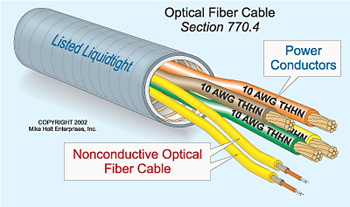

Nonconductive (Fig. 1 above). These fibers contain nothing that can conduct electricity, so they won't accidentally energize or be energized even when closely associated with electrical conductors.

You must meet Chapter 3 raceway requirements, but there are exceptions. For example, when your raceway contains only nonconductive cables, you can ignore the Chapter 3 and Chapter 9 wire fill requirements. Otherwise, those requirements apply (Fig. 2).

Nonconductive optical fiber cables, but not conductive optical fiber cables, can occupy the same cable tray or raceway as conductors for electric light, power, and Class 1 circuits operating at 600V or less.
