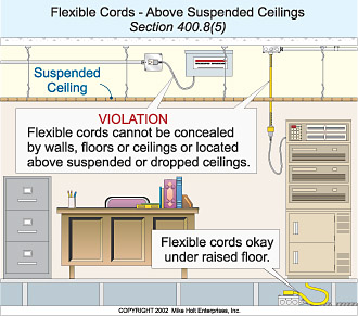

Art. 400 also includes a list of six uses not permitted for flexible cords. Consider the first item: you can't use cords to substitute for the fixed wiring of a structure. Requirements like these demonstrate the fact that flexible cords can't be used to get around Chapter 3 wiring methods.
You can't run cords in suspended ceilings or other “out-of-sight areas” (Fig. 1 above). Why is it OK to wire a luminaire with a cord when it's in the open, but not OK to use that same cord in a suspended ceiling? When a cord isn't in a concealed space, you can inspect it for damage caused by insects and rodents. Inside a suspended ceiling, these pests can chew through the cord and create a fire hazard you may not discover until it's too late. However, you can put cords within a raised floor not used for environmental air because this isn't considered a concealed space. See Art. 100 for the definition of “exposed.”
