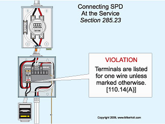

Avoid unnecessary bends in SPD conductors [285.12], and don't make the conductors any longer than necessary. You can connect only one conductor to a terminal, unless the terminal is identified for multiple conductors [110.14(A)] (Fig. 1).

Type 1 SPD — You can install Type 1 SPDs [285.23] on the supply side of service equipment [230.82(4)] (Fig. 2). It's also common to install them on the load side of service equipment per 285.24, based on the energy levels encountered there. You must connect them to one of the following:
(1) Service neutral conductor.
(2) Grounding electrode conductor.
(3) Grounding electrode for the service.
(4) Equipment grounding terminal in the service equipment.
