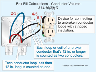

Box fill calculations
To determine box fill:
  1. Count the number of conductor volumes.
  2. Add them up.
This will give you the total volume of the conductors, devices, and fittings. When counting conductor volumes, calculate each one per Table 314.16(B).
Count as a single conductor volume:
  • Any conductor that runs through, or terminates in, a box [314.16(B)(1)].
  • One or more internal cable clamps, based on the largest conductor that enters the box [314.16(B)(2)].
  • Each luminaire stud or hickey, based on the largest conductor that enters the box [314.16(B)(3)].
  • Equipment grounding conductors, based on the largest equipment grounding conductor that enters the box [314.16(B)(5)].
Count as two conductor volumes, each:
  • Loop or coil of unbroken conductor having a length at least twice the minimum length required for free conductors in 300.14 [314.16(B)(1)] (Fig. 1).
