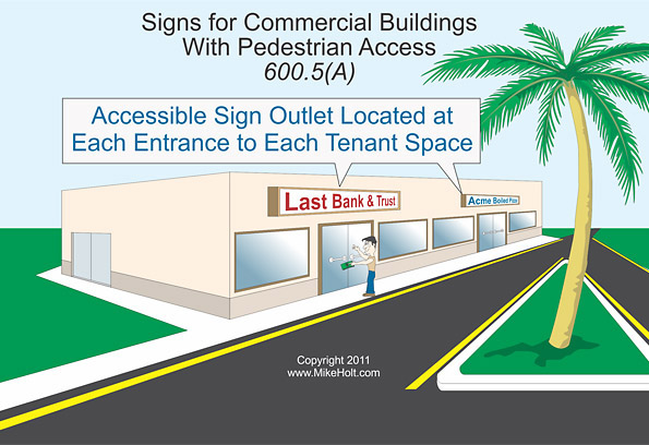

Provide a sign outlet at the entrance of each tenant space in a commercial building or occupancy accessible to pedestrians. Supply each outlet with an individual branch circuit rated at least 20A [600.5(A)] (Fig. 1).
Fig. 1. Each commercial building or occupancy accessible to pedestrians must have at least one sign outlet supplied by a branch circuit rated not less than 20A.
