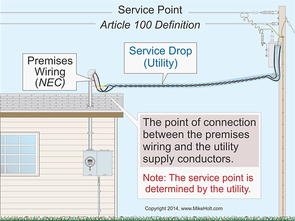

    To correctly apply the requirements of Art. 230 (see The Eight Parts of Article 230), you must understand what a service conductor is and how it relates to the overall installation. Three Art. 100 definitions help with that understanding:
    1) Service conductors. The conductors from the service point to the service disconnecting means. Conductors upstream of the service point aren’t service conductors — they’re electric utility conductors (service drop or service lateral).
    Fig. 1. The service point is defined as the point of connection between the electric utility supply conductors and the premises wiring.
    2) Service point. This is the point of connection between the serving electric utility and the premises wiring. This is where the requirements in Art. 230 really begin (Fig. 1).
    3) Service equipment. The necessary equipment, usually consisting of circuit breakers or switches and fuses and their accessories, connected to the load end of service conductors at a building or other structure, and intended to constitute the main control and cutoff of the electrical supply. Service equipment doesn’t include individual meter socket enclosures [230.66].
    Service conductors originate at the serving electric utility (service point) and terminate on the line side of the service disconnecting means. If the conductors come from any source other than the electric utility, then they’re not service conductors. Keep these concepts in mind when applying Art. 230 so you don’t inadvertently treat feeders as service conductors or vice-versa.
