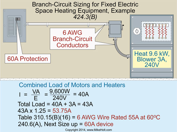

Let’s run through an example problem to relate this back to an actual installation scenario.
What size conductor and overcurrent device are required for a 9.60kW, 240V fixed-electric space heater that has a 3A blower motor with 60°C terminals? (Fig. 1)
Fig. 1. This example problem shows how to select an adequate sized branch circuit conductor and protective device for a fixed electric space heating unit.
Step 1: Determine the total load:
I = W ÷ E = 9,600W ÷ 240V = 40A
I = 40A + 3A blower motor = 43A total
Step 2: Size the conductors at 125% of the total current load [110.14(C)(1), 210.19(A)(1), and Table 310.15(B)(16)]:
Conductor = 43A × 1.25 = 53.75A
A 6 AWG conductor is rated 55A at 60°C.
Step 3: Size the overcurrent device at 125% of the total current load [210.20(A), 240.4(B), and 240.6(A)]:
Overcurrent protection = 43A × 1.25 = 53.75A
Using the next size up rule, choose a 60A OCPD.
