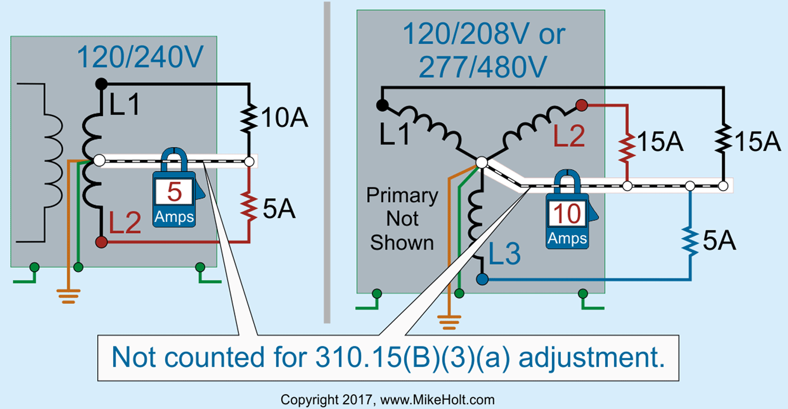

The following factors help determine if the neutral conductor is considered a current-carrying conductor for the conductor ampacity adjustment of Sec. 310.15(B)(3)(a) [Sec. 310.15(B)(5)]:
• Both the neutral and ungrounded conductors of a 2-wire circuit carry current. So, both are considered current-carrying.
• The neutral conductor that only carries the unbalanced current of a 3-wire, single-phase, 120/240V circuit, or 4-wire, 3-phase, 120/208V or 277/480V wye-connected circuit, isn’t considered a current-carrying conductor (Fig. 1).
Fig. 1. Neutral conductors that carry only unbalanced current from other conductors from the same circuit aren’t considered current-carrying conductors.
