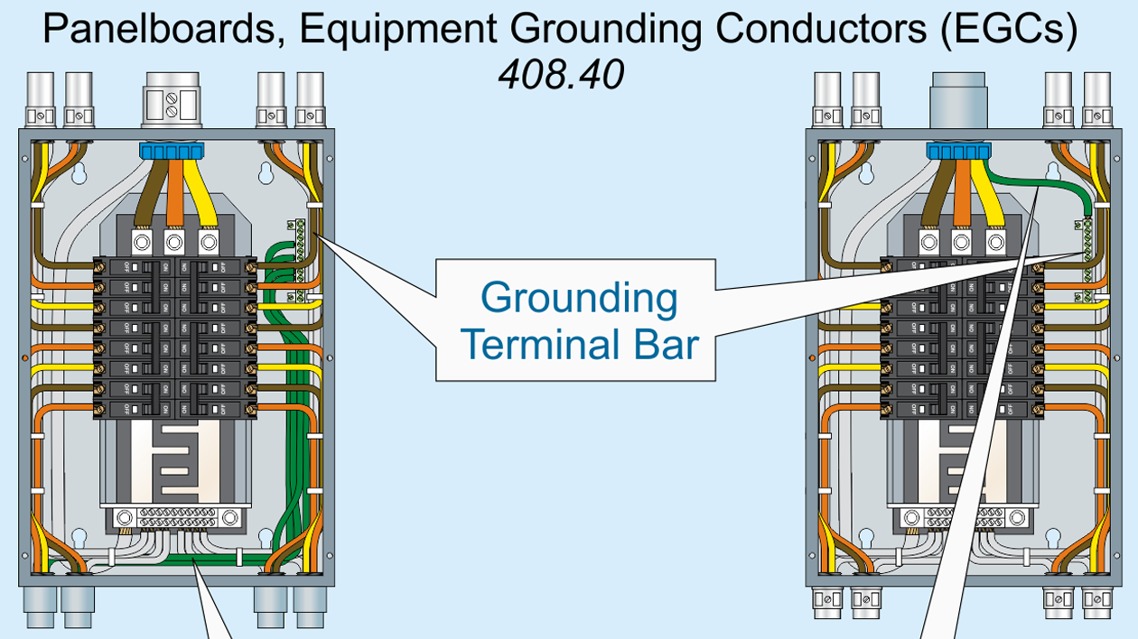

Equipment grounding conductor
Metal cabinets containing panelboards must be connected to an equipment grounding conductor (EGC) of a type recognized in Sec. 250.118 [Sec. 215.6 and Sec. 250.4(A)(3)]. Where a panelboard cabinet contains EGCs of the wire type, a terminal bar for the EGCs must be installed and bonded to the metal cabinet [Sec. 480.40] (Fig. 3).
EGCs are not permitted to terminate on the neutral terminal bar except as permitted by Sec. 250.142(A) for services and separately derived systems.
Many panelboards are rated for use as service disconnects, which means they are supplied with a main bonding jumper [Sec. 250.28]. You cannot install this screw or strap except when the panelboard is used for a service disconnect [Sec. 250.24(A)(5)] or a separately derived system [Sec. 250.30(A)(1)].
