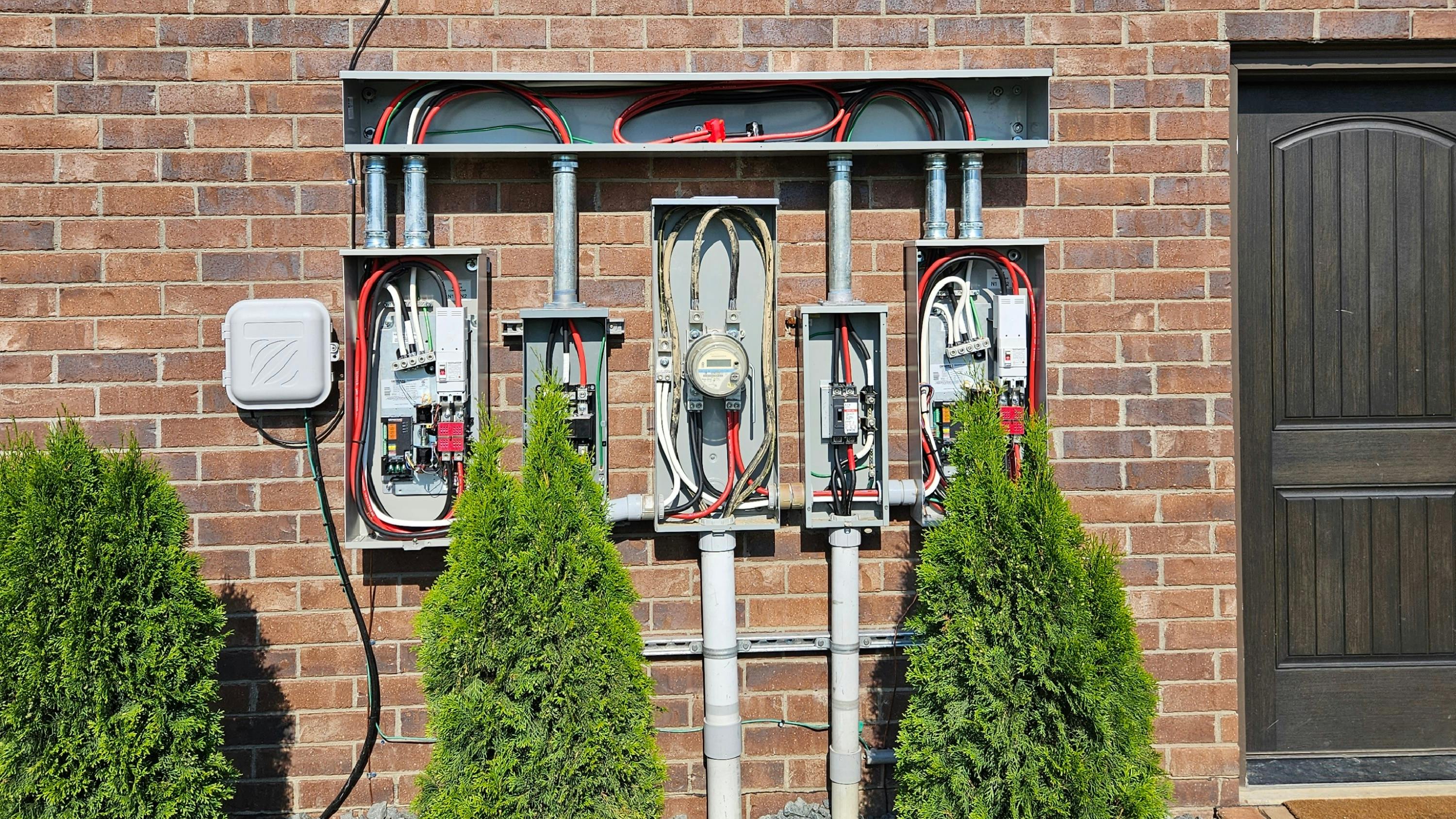

Section 312.11, Enclosures with Switches or Overcurrent Protective Devices
New restrictions apply to service conductors passing through enclosures that contain switches or overcurrent protective devices.
This change prohibits service conductors from passing through enclosures that contain circuit breakers or switches but are not the service equipment.
There is a requirement in Sec. 230.7 that indicates that service conductors may not occupy the same raceway — including wireways — as conductors that are not service conductors. That rule ensures that the service conductors cannot fault to a feeder circuit because such a fault would bypass the feeder’s OCPD and result in energized conductors even with the breaker turned off.
There has never been a requirement that addressed the same hazard in enclosures — until now. Within the service equipment, service conductors may be spliced, tapped, or pass through the enclosure. This is needed because splicing a PV system onto the service conductors is an extremely common practice and should not be prohibited. It is worth noting that this rule only applies to enclosures that contain switches or fuses, so splicing or feeding through a CT enclosure or meter socket enclosure is still allowed, although the local utility may not allow it (Photo 2).
