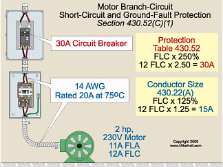

Example: What size conductor and inverse time circuit breaker are required for a 2-hp, 230V, single-phase motor?
Step 1: Determine the branch-circuit conductor [Table 310.16, 430.22(A), and Table 430.248]: 12A x 1.25 = 15A
A 14 AWG copper conductor is rated 20A at 75°C [Table 310.16]
Step 2: Determine the branch circuit protection [240.6(A), 430.52(C)(1), and Table 430.248]: 12A x 2.50 = 30A
