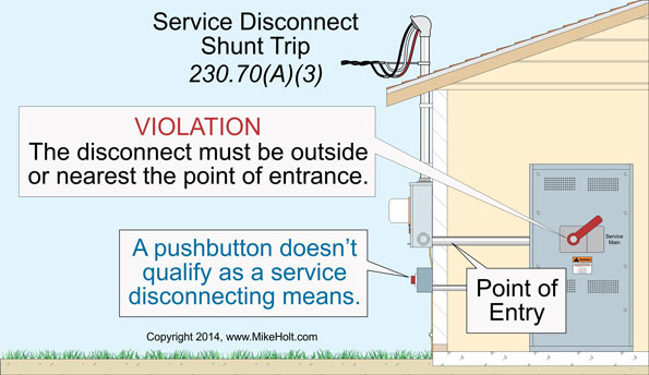

If a remote-control device (such as a pushbutton for a shunt-trip breaker) is used to actuate the service disconnecting means, the service disconnecting means must still be at a readily accessible location either outside the building, or nearest the point of entry of the service conductors as required by Sec. 230.70(A)(1) [230.70(A)(3)] (Fig. 2). See the definition of “Remote Control” in Art. 100.
Fig. 2. Where a remote-control device is used to actuate the service disconnecting means, the disconnecting means must be placed at a readily accessible location in accordance with 230.70(A)(1).

A shunt-trip button doesn’t qualify as a service disconnect because it doesn’t meet any of the above requirements.
