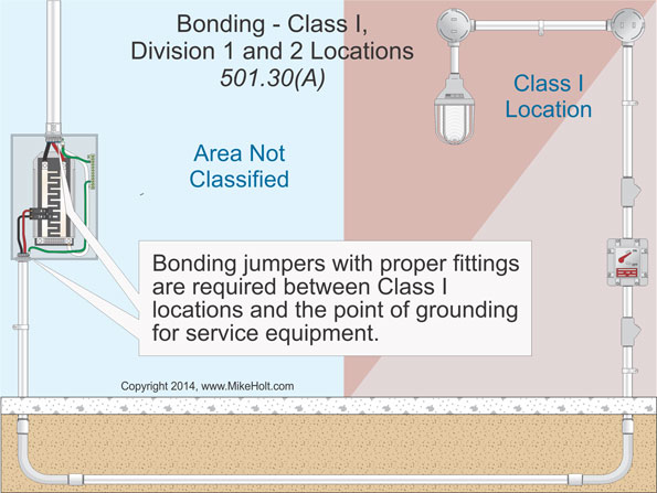

Q. What are the grounding and bonding requirements for Class I locations?
A. Because of the explosive conditions associated with electrical installations in hazardous (classified) locations [500.5], electrical continuity of metal parts of equipment and raceways must be ensured — regardless of the voltage of the circuit.
Locknuts aren’t suitable for bonding purposes in hazardous (classified) locations; thus bonding jumpers or other approved means of bonding must be used. Such means of bonding apply to all intervening raceways, fittings, boxes, enclosures, etc. between Class I locations and service equipment [501.30] (Figure).
Regardless of the circuit voltage, electrical continuity of metal parts of equipment and raceways in hazardous (classified) locations must be ensured by bonding-type locknuts, bushings, wedges, or bushings with bonding jumpers [250.92(B)(4)]; whether or not equipment grounding conductors of the wire type are installed in the raceway [250.100].
A separate equipment grounding conductor isn’t required if a metal raceway is used for equipment grounding. Threaded couplings and hubs made up wrenchtight provide a suitable low impedance path [250.100].
Flexible metal conduit and liquidtight flexible metal conduit must have an equipment bonding jumper of the wire type installed in accordance with Sec. 250.102. Bonding jumpers are sized in accordance with Table 250.122, based on the rating of the overcurrent device [250.102(D)], and where installed outside of a raceway, the length of bonding jumpers must not exceed 6 ft — and they must be routed with the raceway [250.102(E)(2)].
