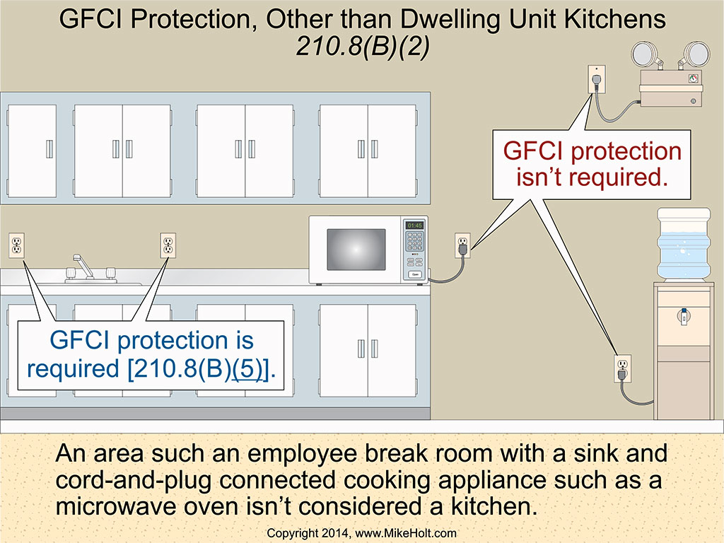

1) Bathrooms. 15A and 20A, 125V receptacles installed in commercial or industrial bathrooms must be GFCI protected. See the definition of “Bathroom” in Art. 100. Note: A 15A or 20A, 125V receptacle isn’t required in a commercial or industrial bathroom, but if one is installed, it must be GFCI protected.
2) Kitchens. 15A and 20A, 125V receptacles installed in a kitchen, even those that don’t supply the countertop surface, must be GFCI protected. A kitchen is an area with a sink and permanent provisions for food preparation and cooking [Art. 100]. GFCI protection isn’t required for receptacles rated other than 15A and 20A, 125V in these locations. Also, GFCI protection isn’t required for hard-wired equipment in these locations. An area such an employee break room with a sink and cord-and-plug-connected cooking appliance such as a microwave oven isn’t considered a kitchen.

5) Sinks. 15A and 20A, 125V receptacles installed within 6 ft of the outside edge of a sink must be GFCI protected.
