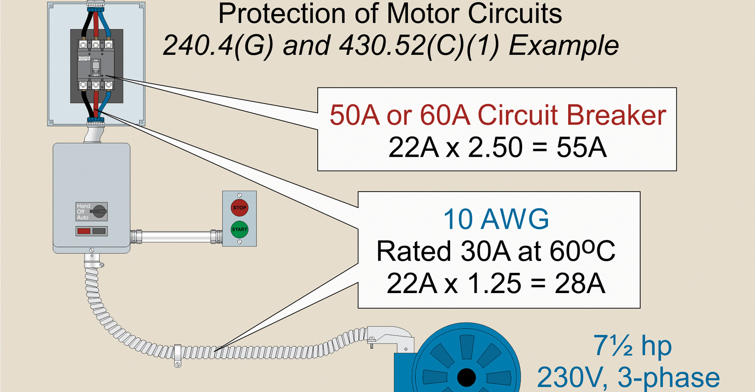

What about overcurrent protection for motors? Motor circuit conductors must be protected against short circuits and ground faults in accordance with Sec. 430.52 and Sec. 430.62 [430.51]. Here’s an example calculation that shows you how to determine the proper protection.
What size branch-circuit conductor and overcurrent protection device (circuit breaker) is required for a 7½-hp, 230V, 3-phase motor with 60°C terminals? (Fig. 2).
Solution: Table 240.4(G) directs us to several parts of Art. 430.
Step 1: Determine the branch-circuit conductor size [Table 310.15(B)(16), 430.22, and Table 430.250]:
FLC = 22A [Table 430.250]
22A × 1.25 = 28A [240.6(A)]
Step 2: Determine the branch-circuit overcurrent protection size [240.6(A), 430.52(C)(1) Exception No. 1, and Table 430.250].
Inverse Time Breaker:
22A × 2.50 = 55A
Answer: 10 AWG rated 30A at 60°C branch-circuit conductor [110.14(C)(1)(a), Table 310.15(B)(16)] with a 60A (next size up) overcurrent protection device [240.6(A)].
