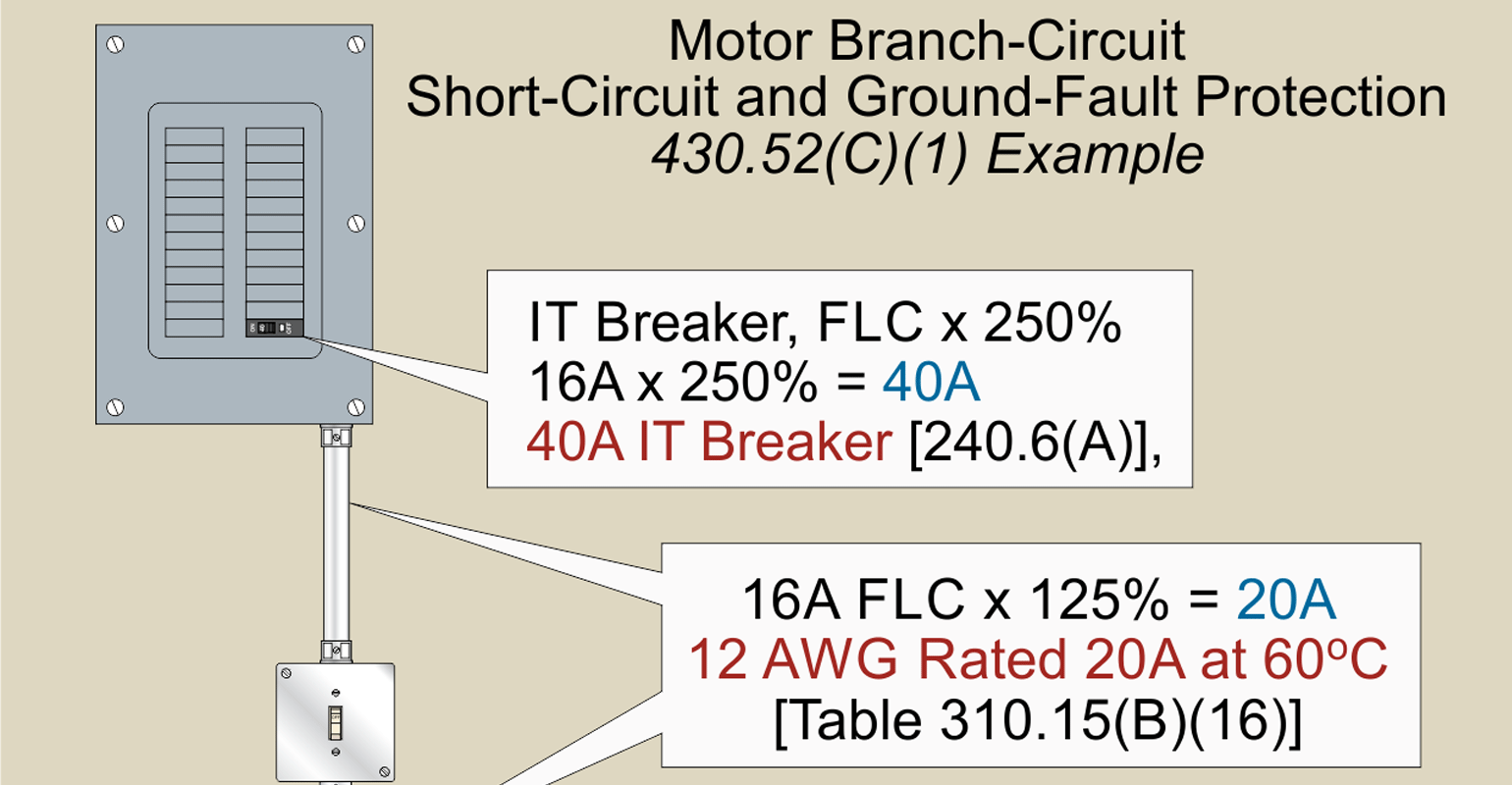

What size branch-circuit conductor and OCPD (circuit breaker) is required for a 1-hp, 115V, single-phase motor with 60°C terminals (Fig. 3)?
Fig. 3. Here’s a simple example of how to protect a motor branch circuit from short circuits and ground faults.
Answer: 12 AWG rated 20A at 60°C branch-circuit conductor with a 40A OCPD.
Now Art. 430 requirements apply [Table 240.3].
Sec. 460.6(A)(1), use motor full-load current (FLC) from appropriate tables to size conductors and OCPD. Table 430.248 gives the motor FLC for a 1-hp, 115V motor, 16 FLC.
Motor conductor size, use Sec. 430.22, 16 FLC × 125% = 20A, Table 310.15(B)(16), 12 AWG rated 20A at 60°C [110.14(C)(1)(a)(1)].
Motor OCPD size, use Sec. 430.52(C), circuit breaker uses 250% of FLC, 16 FLC × 250% = 40A which is a standard size [240.6(A)].
