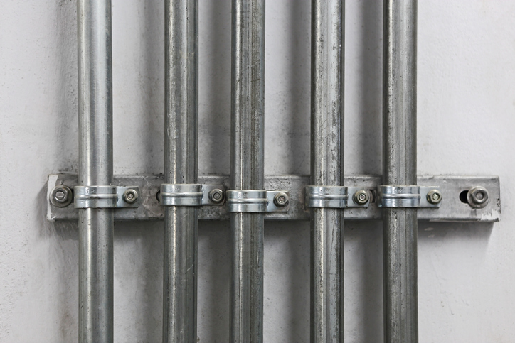

Question: Electrical metallic tubing (EMT) shall be securely fastened in place within a maximum of _____ feet from a box.
A.    three
B.    five
C.   six
D.   eight
See the answer below.
Answer: Three
Explanation: Section 358.30(A) requires electrical metallic tubing (EMT) to be securely fastened within three feet of a box. Exception No. 1 permits this distance to be increased to five feet for unbroken lengths where structural members do not readily permit fastening within three feet.
