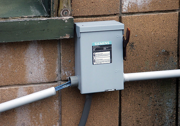

No Room to Grow
As indicated by these two photos, when PVC thermal expansion and contraction is not taken into consideration when designing and installing PVC conduit runs, the pipe run can simply self-destruct. Section 300.7(B) requires expansion fittings to be used on raceways “where necessary to compensate for thermal expansion and contraction.” Section 352.44 more specifically requires expansion fittings to be used for PVC conduit where the length change for a straight run between securely mounted items is expected to be ¼ in. or greater, in accordance with Table 352.44.
The pipe run in the photo is approximately 30 ft long. If we assume a temperature change from 95°F in the summer to about 5°F in the winter — which happens on a regular basis where I live in New England — then there is a temperature change of 90°F. According to Table 352.44, a 100-ft run would experience a length change of about 3.65 in. Therefore, this 30-ft pipe run would experience a length change of approximately
1 in. If an expansion fitting is not used, this length change will cause more than enough strain and pressure on the couplings, clips, and connectors to cause distortion and breakage. That is exactly what happened to this installation.
