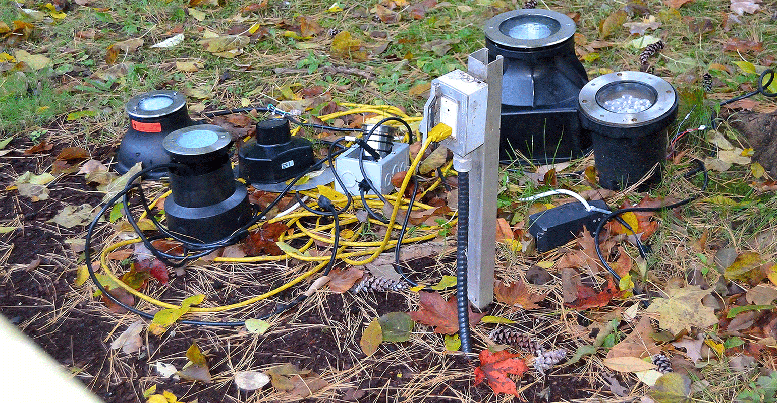

The cover on this receptacle box has a few problems. First, it is not meant to be installed vertically with the cover flipping open to the side. It is designed to be installed horizontally with the cover flipping up. When used correctly, this enclosure would be weatherproof when the cover is closed. Not following instructions included with a listed product is a violation of Sec. 110.3(B). Secondly, it is not weatherproof while the attachment plug is inserted. Section 406.9(B)(1) requires this outdoor wet location receptacle enclosure to be weatherproof while in use. A “bubble cover” would have been a better option here. Section 406.9(B)(1) also requires any outlet box hood used for this purpose to be listed and identified as “extra duty.” That same Section also requires 15A or 20A, 125V and 250V receptacles installed in wet locations to be listed and identified as weather-resistant type receptacles. The liquidtight flexible metal conduit (LFMC) connected to the box is not properly secured within 12 in. of the box as required by Sec. 350.30(A). Section 350.10(3) permits LFMC to be used for direct burial applications where the LFMC is listed and marked for direct burial.
