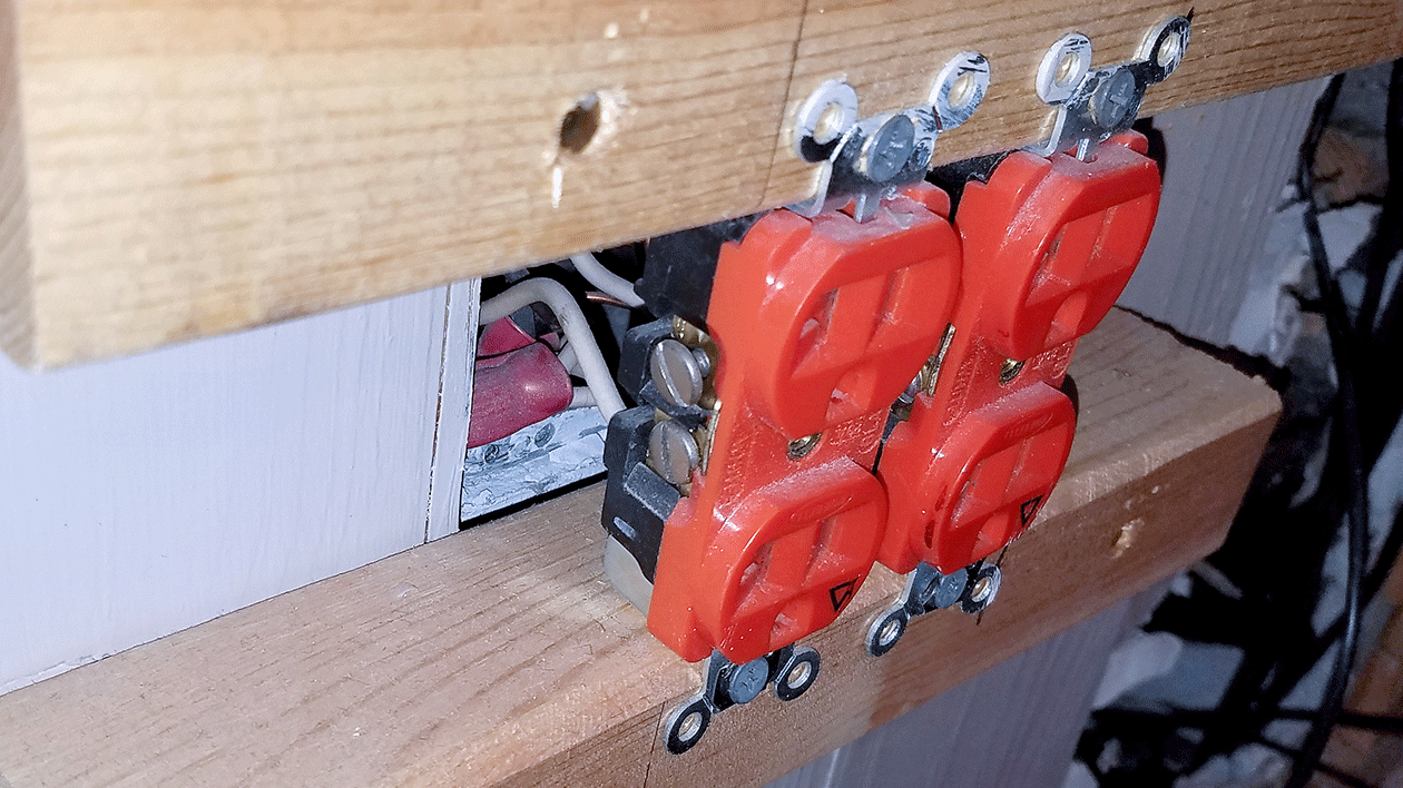

Rogue Receptacle Installation
Brandon Spivey, owner of Event Horizon & Services in Nashville, Tenn., was kind enough to share this photo with us. He said, “The plugs were covered with a fabric panel with no other housing.” Brandon also said he is “new to this all, and learning, but this seems like a Code violation.” Brandon, you are correct. There are definitely Code violations here.
Section 406.5 requires receptacles to be mounted in identified boxes or assemblies. Attaching receptacles to a couple of wooden blocks does not meet Code minimum requirements. It appears these boards were being used as some type of “box extender.” A listed extension ring or listed box extender should have been secured to the flush-mounted box instead. The exposed energized terminals create a shock hazard and violate the rules of Sec. 406.5(I), which requires receptacles to be enclosed so that no live terminals are exposed to contact. The lack of a box cover for the outlet box is a violation of Sec. 314.25. According to Brandon, an equipment grounding conductor (EGC) run separately from the circuit conductors was connected to these isolated ground receptacles. This violates Sec. 250.146(D) and Sec. 300.3(B) if the EGC was not run with the circuit conductors.
