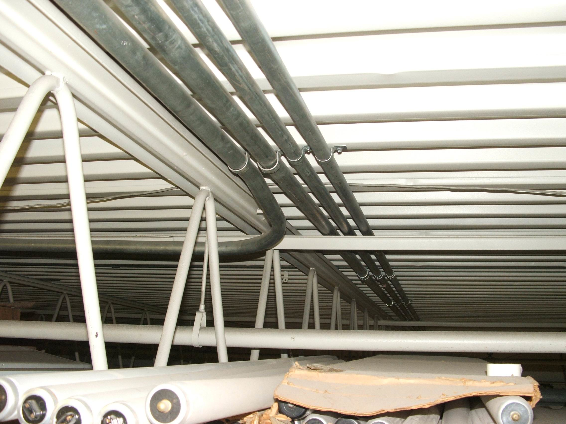

Securing electrical metallic tubing (EMT) raceways directly to the bottom of metal-corrugated sheet roof decking is a violation of Sec. 300.4(E). Raceways, cables, and boxes installed beneath this type of roof decking must be installed and supported in a manner that provides at least 1½ in. of space between the lowest surface of the roof decking and the top of the raceway, cable, or box. Section 410.10(F) additionally requires luminaires installed beneath this type of roof decking to be installed and supported so there is at least 1½ in. between the lowest surface of the roof decking and the top of the luminaire. This 1½ in. spacing is needed to reduce the likelihood of damage to the wiring methods and equipment, which can be caused by the long screws roofers use to make repairs to this type of roofing. I have seen many instances where those long roofing screws have penetrated directly into raceways or cables, causing massive damage to the wiring. Rigid metal conduit (RMC) and intermediate metal conduit (IMC) are two wiring methods that are permitted to be installed without the 1½ in. spacing from the roof decking.
