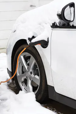

Locate the charging equipment so that it connects to the vehicle using only the supplied charging cable (PaulMaguire/collection/Thinkstock).

Locate the charging equipment such that it can connect to the vehicle using only the supplied charging cable [625.50]. You can’t use any intermediary wiring, such as a custom “extension cord” for this purpose; this must be a direct connection [625.50] using a listed cord or cable [625.5, 625.17]. So a location error can’t be fixed without redoing the installation.
Allow for cable length required to reach not the vehicle but its supply connector. Because the charging cable is short [625.17], the geometry involved in parking the vehicle and orienting its charging connector limits your location choices. If you’ve ever pulled up to a gas pump in a rental car only to realize the filling cap is on the side away from the pump, you can picture this problem.
