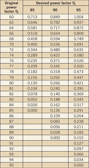

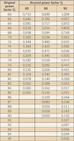

Now that you have this number, you can refer to a PF correction table (Table 1). Looking at the Table, go in from the left with the existing PF, and then come down from the top with the desired PF. Where the two lines intersect, you'll find the multiplier you need. Take that multiplier and multiply the motor's input kW by it. This will give you the required kVAR of correction.

In our case, we want to correct the PF from 85% to 95%. Looking at Table 1 and going down the 95% column and across the 85% column, we see that the intersection is at 0.291, which is the multiplier we need.
Step 5: Multiply input kW by multiplier
The calculation is 78.8 × 0.291 = 22.9 kVAR.
