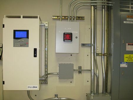

All of the filters are installed between the distribution transformers and the panel main breaker. Four of the 50A filters are installed on the first floor of a computer room, while the remaining six 50A filters and the 100A filter are located on the second floor of a different computer room. Two of the 50A filters on the second floor installation are connected in parallel to the same panel, because this was easier than using a single 100A filter. According to Ilinets, installation was not difficult; however, the 100A filter was more challenging, given the larger size, heavier weight, and the fact that the floor was raised. Overall, the most difficult part of the installation was getting approved power outages to connect the filters to the panels, says Ilinets.
StacoSine active harmonic filters use power electronic technology to monitor the non-linear loads and dynamically correct every harmonic order from the 3rd through the 51st. Through an injection and cancellation process, the sine wave is restored and distortion is reduced to less than 5% total harmonic distortion (THD), meeting the stringent IEEE 519 Standard. By injecting a compensating current into the load, the waveform is restored, dramatically reducing distortion to below 5% THD. Power is moved from the AC source to the DC electronic platform, then back to the AC. This occurs at a very rapid rate, allowing for cancellation of the high frequency output current, followed by determining the precise value of the injected load current. The power electronics platform continuously adapts to rapid load conditions, yet maintains a small physical footprint. The 50A filters installed at SLAC are wall mounted to further minimize floor space requirements. In addition to the elimination of harmonics, installation of the filters also allows SLAC to use smaller than K-13 rated transformers because there’s much less heat impact on the equipment and the cables, says Ilinets.
